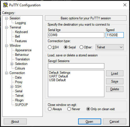

Hi. I am attempting to get a basic USB_FS to communicate between my STM32 Board (STM32756-EVAL) and my PC, through PuTTY. The following are the configs on my PuTTY connection.
0693W00000Y9LmUQAV.pngAnd the following is my code in main.c:

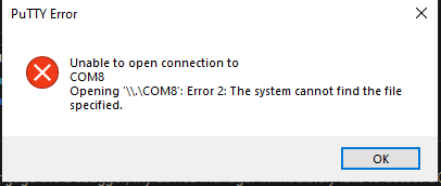

Whenever I engage the Debugger, my device manager immediately fails to detect COM8 (the STM32 USB_FS port). I am unsure why that is. The error message on PuTTY:
USB device operation requires real-time response. Debugger is intrusive, it causes the device to lose connection with host.
