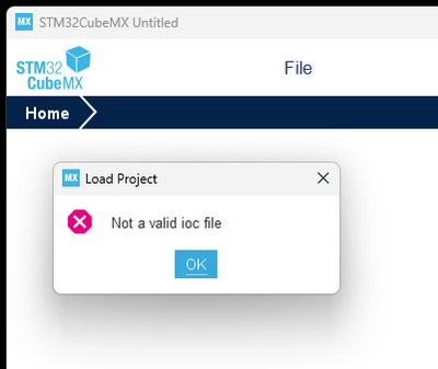

Cannot open ico file from link provided by ST

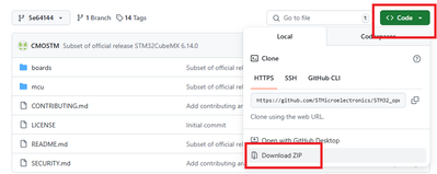

Hello @yilmazkircicek ,
I've normally opened H74_Discovery_STM32H745I-DISCO_STM32H745XIH_Board_AllConfig.ioc as shown in this screenshot:
How did you download that file? please download the all package from github:
Unzip the package and open the ioc file with the latest version of CubeMx (the latest version is 6.14)

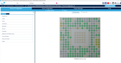

Thanks for the link, I have tried "H74_Discovery_STM32H745I-DISCO_STM32H745XIH_Board_AllConfig.ioc" and here is the result; a perfect forward and backward compatibility :)

I am using 6.14.0 version of CubeMx.

Now I have downloaded as you described and wokring normally. In first time, I had right clicked the file name and clicked Save linked content as... at first time.
That's my bad. Thanks for clarification.

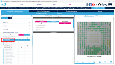

BTW, the feature that I interested did not initialized in .ioc file, like FatFS, MDMA etc... I mean, not the exact file that is used (or can be used) in H745-DISCO

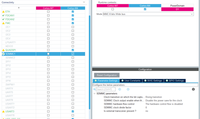

‎2025-04-14 6:00 AM - edited ‎2025-04-14 6:01 AM
The configuration available for the provided ioc files is intended to just provide a primitive hardware initialization not to configure high level middlewares like FatFS, LWIP, FreeRTOS etc ..
And the SDMMC is already set:
You need to add them yourself.
