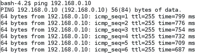

Sorry in advance for my English. I am also very new to embedded systems and softwares worlds.
I am currently trying the lwIP TCP/IP stack on a STM32756G-EVAL2 (STM32F756NGH) board. On one end, I have a Red Hat PC with a network interface used specifically to connect with the board through Ethernet. On the other end, the board linked to the PC with RJ-45 cable. I use STM32CubeIDE v1.5.0 as the IDE for developping my softwares, and the board is connected to the PC via ST-LINK v2.1. I am able to flash and debug my binaries without any issues.
My PC is network-configured with a static IP address (192.168.0.2), a netmask (255.255.255.0), a gateway (192.168.0.1) and a MAC address. The board is configured with a static IP address (192.168.0.10), a netmask (255.255.255.0), a gateway (192.168.0.1) and a MAC address (by default 00:80:E1:00:00:00).
To reproduce the issue as stated in the title (I will explain more specifically the issue below), here is what I do:

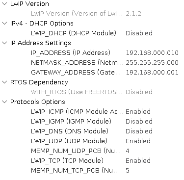

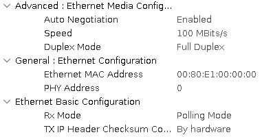

- In the ioc file, in Pinout & Configuration, I go to Connectivity, ETH and activate it as MII. There are the settings. PHY Address must be set to something different of 1 otherwise nothing works at runtime lwIP-side. I have seen some people talking about this being a bug on the STM HAL F7 Ethernet.
- In Middleware, I enable LWIP. I deactivate LWIP_DHCP in General Settings, and I enable LWIP_BROADCAST_PING and LWIP_MULTICAST_PING in Key Options (at IPv4 - ICMP Options). Other than these changes, everything else stays at default.
- Before the code is being generated, I accept the request from the automatic clock resolver, as HCLK is not set to 216 MHz. Now it is set to 216 MHz and I generate the code.

- Nonetheless, with the program running on the board, I refresh an ifconfig command on my PC terminal and I can see that I indeed receive UDP packets each second approximately (as written in my program). These are not ICMP packets as I do not run the ping command for this purpose.
Thus, I do not really understand why it is not working. I tried to change a lot of settings of the ETH and LWIP in the ioc, as well as doing some little debugging with breakpoints and running through each functions. No errors returned also. I tried with Netconn API and FreeRTOS, same problem: ping requests and responses work but not UDP or TCP. I did not tried sockets but i thought that if RAW API and Netconn API didn't worked, I will be more successful with socket API.
Do you have any ideas or solutions for this kind of issue?
