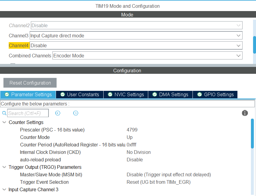

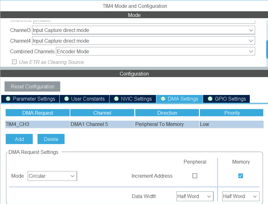

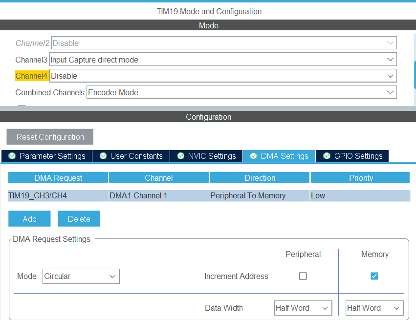

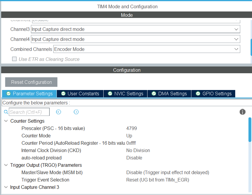

I have a STM32F373 processor and I have 2 Encoders and 3 Input Captures.
I have enabled DMA for input capture.
Timer 4:
0693W00000D1n2KQAR.png0693W00000D1n2PQAR.pngTimer 19:
And I have this code.
My questions are:
  1. Can I use Encoder together with Input Capture if Input Capture has DMA?
  2. What will DMA store inside the arrays input_capture[2]? Is it the counter value? I'm assuming it will be some kind of a counted value, right?
  3. Will this work?

Yes.
IC will capture the CNT value at the time of the event, which is then transferred by DMA.
So in this case, combining Encoder with IC....bad idea?
Do you have another solution?
I think I need to have DMA because if I using interrupts, then the interrupts will...well...interrupt other parts of the code.
STM32MP151AAC3 custom board with STM32-OS as operating system: https://github.com/DanielMartensson/STM32-Computer
It doesn't seem very useful to me.
Solution for what? I don't see you explaining what you want anywhere. There are plenty of other timers on the chip.
Why does it not seems useful? Encoder + IC?
I'm using IC because I want to measure frequecy.
I'm using encoder because I want to measure position.
Use one timer for the encoder and use another timer to measure frequency.
It may be possible to hook up IC to transfer the CNT value from another timer instead, but it's probably not something that HAL supports out of the box.
