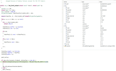

I use STM32F407 with freertos and lwip. Try to setup an UDP server example. Init is ok but with the first answer from the server code blocks at mem_free called from HAL_ETH_ReleaseTxPacket. The client receives the correct message but afterwards the function HAL_ETH_ReleaseTxPacket is called a second time and then I got a "LWIP_MEM_ILLEGAL_FREE("mem_free: illegal memory: double free");" because mem->used is 0.
It is the same if I use CMSYS V1 or V2 and also with initializing the semaphores to 0
‎2023-09-24 10:14 PM - edited ‎2023-09-24 10:31 PM
Package: H7, V1.11.1
uC: STM32H725IGKX
I'm running into the same bug as described by this topic using Freemodbus: the transmission is getting stuck after a sending data for a few minutes.
After implementing the suggested fix the microcontroller it is crashing on some internal FreeRTOS queue configASSERT(...) - again after running a few minutes.
So this bug still persists and isn't fixed :(
