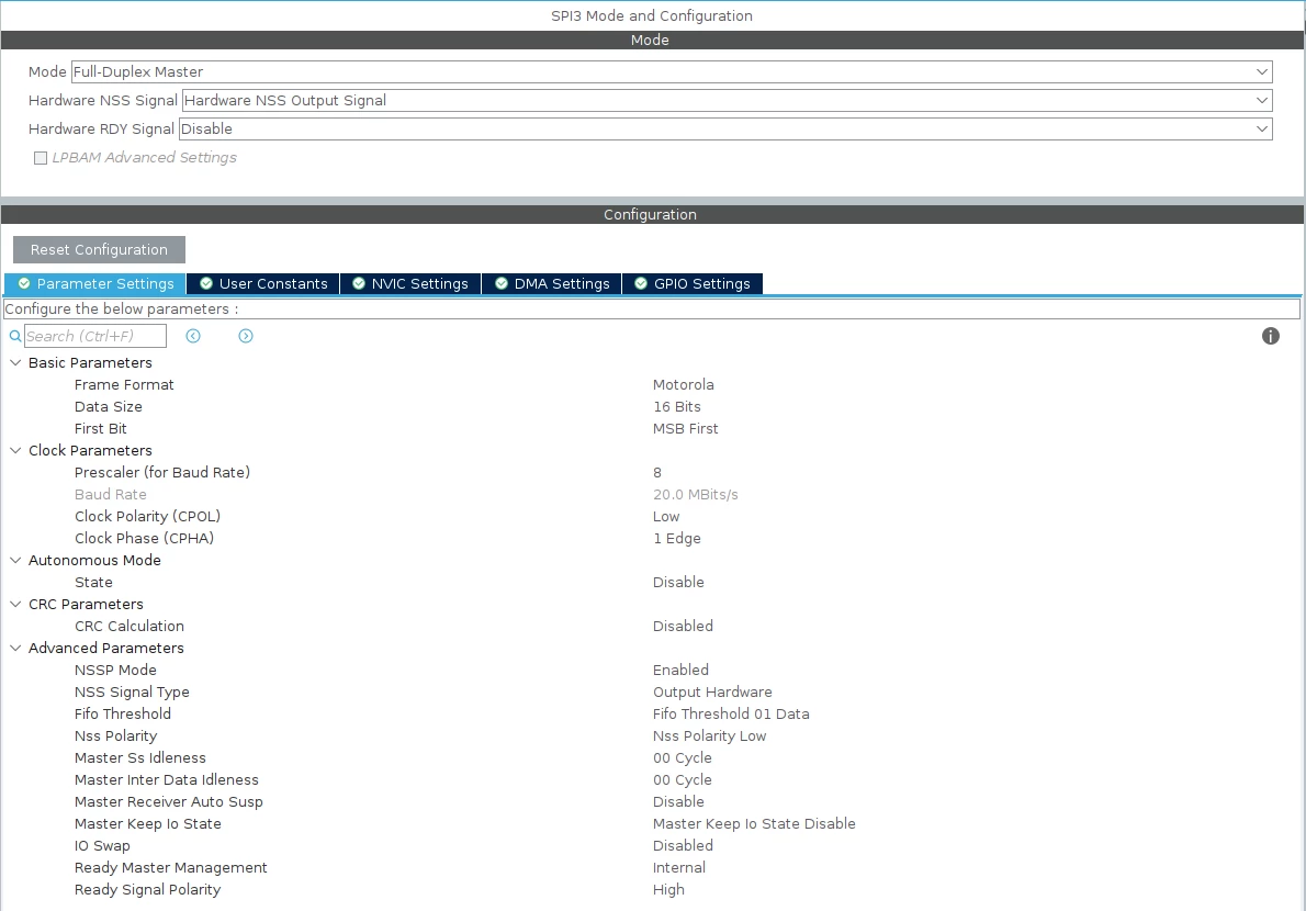

SPI Configuration:
_legacyfs_online_stmicro_images_0693W00000biFzAQAU.pngHowever, in my attempts to speed these transactions up, I have ditched the HAL for writing/reading to/from the SPI peripheral during the steady state program flow.

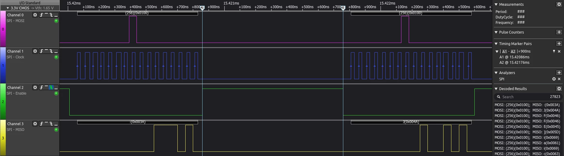

The problem is that I am seeing a large period of inactivity between transfers (about 900 ns), as shown in this logic analyzer trace:
_legacyfs_online_stmicro_images_0693W00000biFx5QAE.pngIn ideal conditions, I should be able to get the desired throughput with 20 MHz SPI. 2 bytes at 20 MHz take 800 ns to transfer, plus the 154 ns pulse --> 954 ns. Multiply by 34 bytes means I should be able to get this done in about 32 us, meeting my 50 us deadline. Actually, I should be able to get away with up to 670 ns delay between 2-byte transfers (not ideal), but 900ns will certainly not work for me.
Where is this delay coming from? Is it a function of the SPI peripheral architecture? Can my code be optimized further in some way? Can I double buffer the data? Where in the spec sheet can I find reference to these limitations? I am willing to make memory and power trade-offs to increase the bandwidth. Is there some workaround I can use to achieve higher SPI throughput given the limitations of the device I am interfacing with?

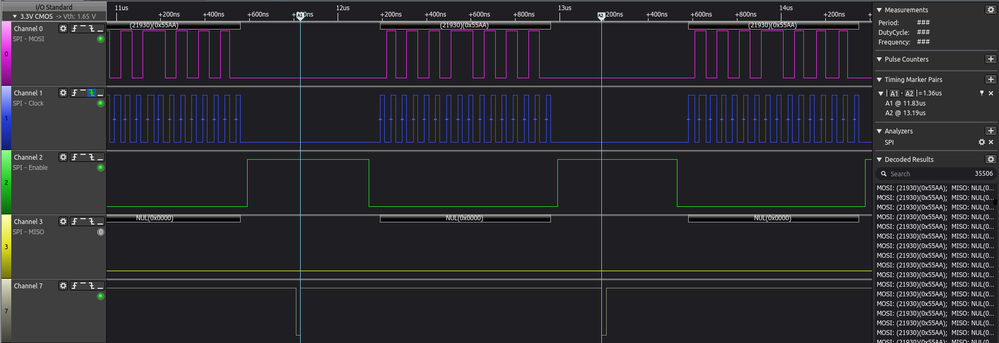

This produces the following waveform (channel 7 is the test pin):
_legacyfs_online_stmicro_images_0693W00000biGZwQAM.pngWith those changes it looks like a SPI transfer can clock in at ~1.36 us. Times 34 transfers --> 46.24 us. Which is just under the my 50 us deadline. Big improvement, but still not really good enough.
