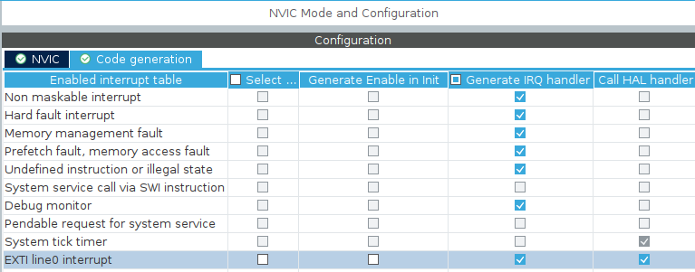

I have configured a GPIO pin as EXTI and configured that the interrupt should not be enabled when initializing the GPIO, (i.e. removed the check mark from "Generate Enable in Init").
If the initialization code is generated in main.c, the interrupt is not enabled (as expected).

However, if the initialization code is generated in separate .h/.c files, the interrupt is erroneously generated.
// In gpio.c
void MX_GPIO_Init(void)
  /* EXTI interrupt init*/
  HAL_NVIC_SetPriority(EXTI0_IRQn, 5, 0);
  HAL_NVIC_EnableIRQ(EXTI0_IRQn);

The problem only exists if more than a single pin is configured as EXTI.
If "Generate Enable in Init" is unchecked for all EXTI lines, the code is generated correctly. However, if at least a one line has the option checked, the IRQ is enabled for all lines.

I escalated the problem to CubeMx team in an internal ticket (ID: 168700 ) to take a closer look at this issue.
