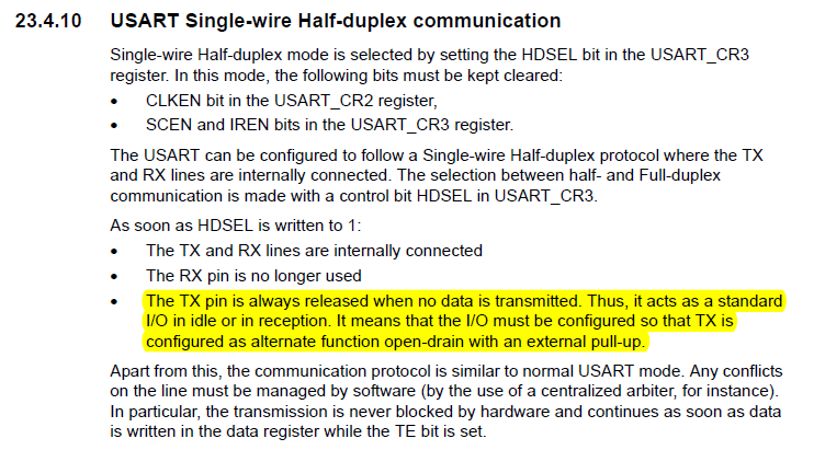

Hi @kha​
According to the reference manual, in half duplex mode, the TX pin is a standard I/O in receive or in transmit. That's why only the TX pin is highlighted.
Regards,
Nesrine.

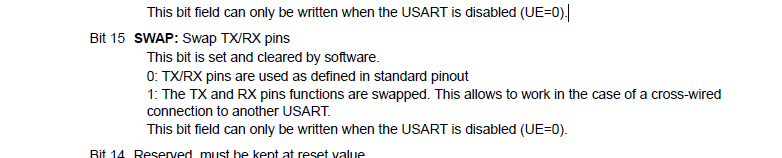

kha
Then there is the 'SWAP' which exchanges the RX and TX pins, notably it will make halfduplex to use the pin normallyused for RX. I have confirmed this to be the case with hardware.

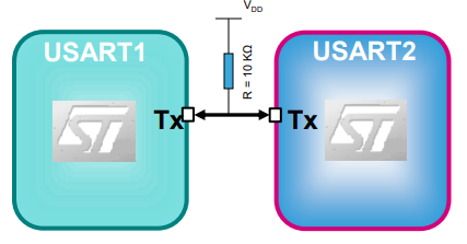

Hi @kha​
As shown in the figure, in USART single wire half duplex mode:
  • TX and RX lines are internally connected
  • TX pin is used for both transmission and reception ==> Only TX pin is used (RX is no longer used)
So, SWAP will exchange the TX and TX pins .
Regards,
Nesrine.

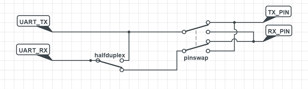

kha
Ok, you lost me this time...
You seem to ignore the fact that I have tested this on real hardware, if swap is enabled on halfduplex UART the physical pin will change.
The "halfduplex" mode connects the TX and RX lines internally on one UART to its TX line, now the swapping feature is on the IO pin side of this and thus will map the (combined) UART TX signal to the RX pin0690X000006DlTtQAK.png.
