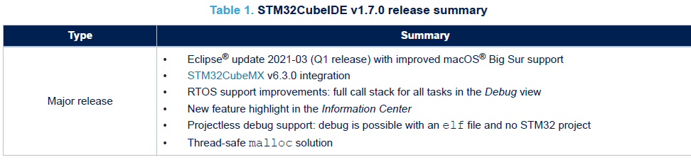

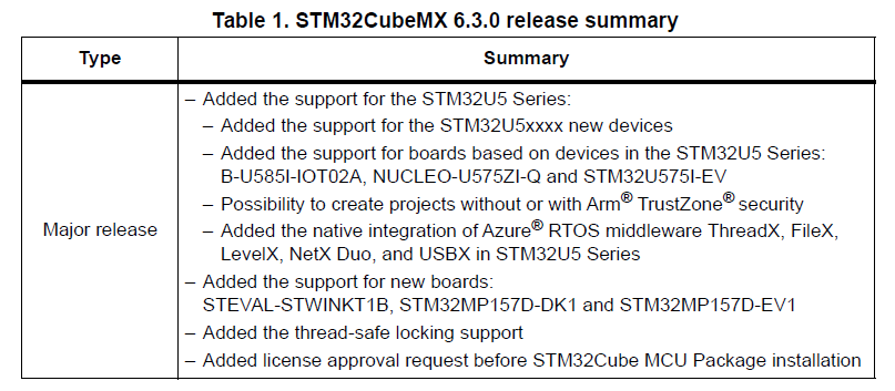

Looks like STM has released a fix for this in the latest STM32Cube IDE 1.7.0 / CubeMX 6.3.0 release according to their release notes:
0693W00000D096uQAB.png0693W00000D09A7QAJ.pngI haven't tested this or investigated the fix, but figured I would update this thread to raise awareness. Note that if my memory serves me correctly, STM released a fix in the past that didn't work. So before anyone deems this a working fix, I would investigate yourself or wait for peer verification. @Dave Nadler​  in case you are curious.
