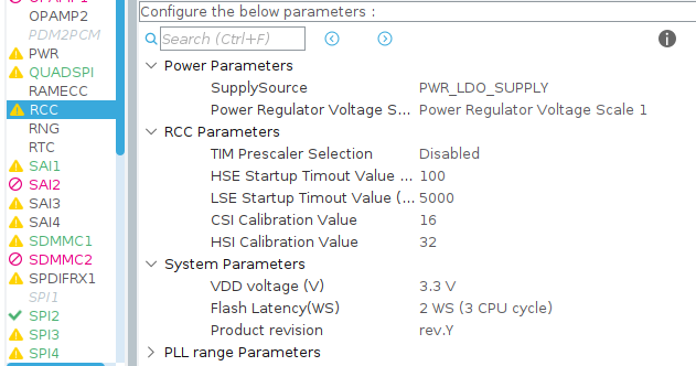

I have updated from stm32cube IDE 1.10.1 to 1.11.0 . After update and open the .ioc file, clock configuration show some problem like the CPU max clock frequency i can't use 480MHz any more.
Do you know anything about this bug?
The H7 Package in CubeMX was updated too from 1.10 to 1.11.0

max clk to choose, depends on core voltage (set:range 0)
+ maybe: chip revision (try: V or Y )

thank you.
Changing the production revision solved my problem
