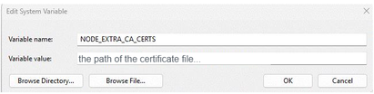

Hi @paolog
In this case, what you need is to configure a proxy or a certificate to be able to access the servers and download packages.
  • Get your certificate from your company IT or company portal.
  • Place it under C:\certificate, for example.
  • Add the Windows environment variable NODE_EXTRA_CA_CERTS with the path to this certificate file. (Make sure that the path has no quotes.)
  • Finally, restart STM32CubeMX2.

Hi @Oussama_TROUDI , thank you for your reply.
I followed the directions on the above link as much as possible, as we don't use Visual Studio Code. We installed the certificate, defined the variable NODE_EXTRA_CA_CERTS to point to the certificate file, and defined proxy in MX2 as "http://Proxy-address:port". But the error is still there.
Should system variable GLOBAL_AGENT_HTTP_PROXY be defined?
Any other option to solve this?
