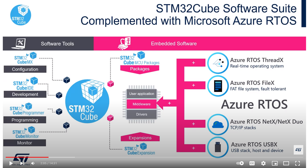

But I'm aware that AZRTOS with NETXDUO may make lwIP redundant with ST
https://www.youtube.com/watch?v=OPVhsJfZA5A from 1:58 he talks about ST changing Middleware offering

Hi @HKabi.1​ ,
Unfortunately there is no plan to support new LwIP version in our middleware offer at least in short term.
As previously stated by @Community member​, ST's recommendation is to use NetXDuo instead of LwIP.
-Amel
