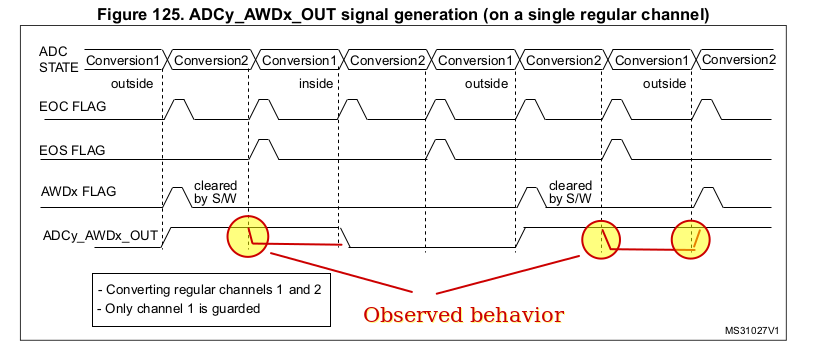

ADCy_AWDx_OUT signal do not work correct for single regular channel, when more channels are sampled in regular sequence. ADC5 AWD1 of STM32G474 .
 Hello ST community,
I use ADC5 of STM32G474 for sampling 2 internal channels in regular sequence, VOPAMP4 and 5 and store data over DMA.
I use ADC5 AWD1 configured for single regular channel VOPAMP5 (tried change to VOPAMP4).
I use ADC5_AWD1_OUT as HRTIM capture trigger reacting on rising edge .
Awaiting behavior to capture time when ADC VOPAMP5 captured signal got out of watchdog window.
Problem is that ADC5_AWD1_OUT go low when ADC finish conversion of another channel (wrong behavior), like AWD1 is configured for all regular channels, but it's configured for single regular channel.
When ADC sampling same channel regularly or same channel in regular sequence, then ADC5_AWD1_OUT stay high for as long as signal is out of watchdog window (correct behavior).
I do check ADC SFR registers in debug mode, all looks correct.

Visualized problem description:
Image from :
en.DM00355726.pdf
RM0440
Reference manual
STM32G4 Series
32-bit MCUs
Rev 2 , October 2019
