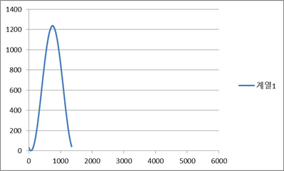

I generated a sine wave of 250Hz and advertised it, but as calculated, I had to get 8000 samples per cycle, but I only got about 1300.
Is there a reason for this?
Below is actually a waveform drawn with Excel by acquiring a cycle sample.

> sConfig.SamplingTime = ADC_SAMPLETIME_15CYCLES;
Conversion time will be 15 + 12 ticks in this case. 15 for sampling and 12 for conversion. With a 30 MHz clock, this is 900 ns
A 250 Hz sine wave period is 4 ms.
4 ms / 900 ns = 4444.
So why is yours different? Perhaps show your code.

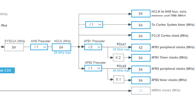

giwonKIM
HI,
I modified my code and settings.

The output sine waveform is 250Hz as it is, and how many samples should be produced at this time?
My calculation is (12+3) / 84MHz = 22400, But if you sample one cycle, there are about 13,000.
DMA is not in use and operates in polling mode.
Thank you.

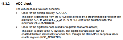

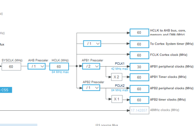

giwonKIM
ADCCLK is shown in the Datasheet like this.
If I set APB2 to 60Mhz and clock divide to 2, is it correct that ADC operates at 30MHz?
So that's your problem. The chip takes time to run code, don't expect to get 5.6 Msps in polling mode.
I understand what you're saying. I'll have to approach it in a different way.
