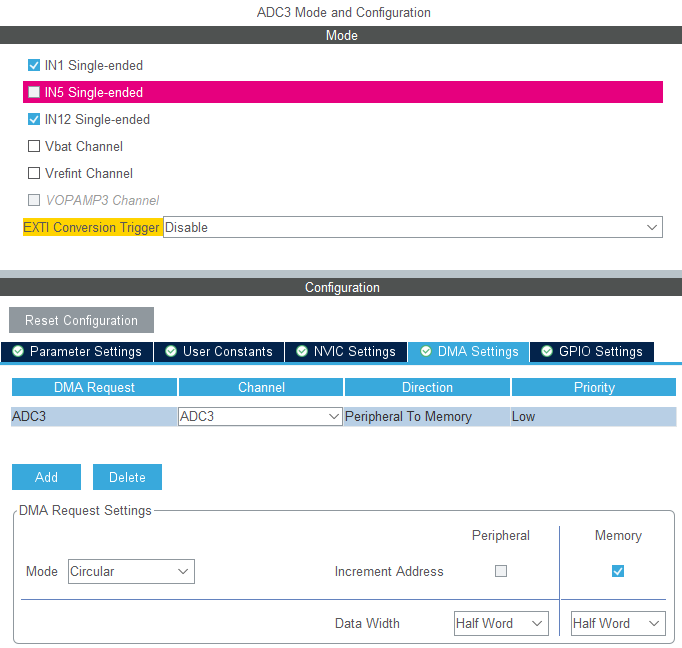

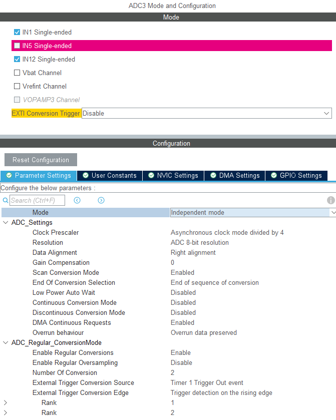

‎2023-05-22 2:36 AM - edited ‎2023-11-20 5:03 AM
It is STM32G4.
I managed to make it work more or less how I wanted. CubeMX setup attached.
In the code I start conversions like this once:
#define NUM_ADC_CONVERSIONS 16
#define NUM_ADC_CHANNELS 2
uint16_t adc[NUM_ADC_CHANNELS];
HAL_TIM_Base_Start_IT(&htim1);
HAL_ADCEx_Calibration_Start(&hadc3, ADC_SINGLE_ENDED);
HAL_ADC_Start_DMA(&hadc3, (uint32_t*) adc, NUM_ADC_CHANNELS);

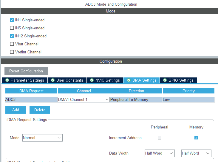

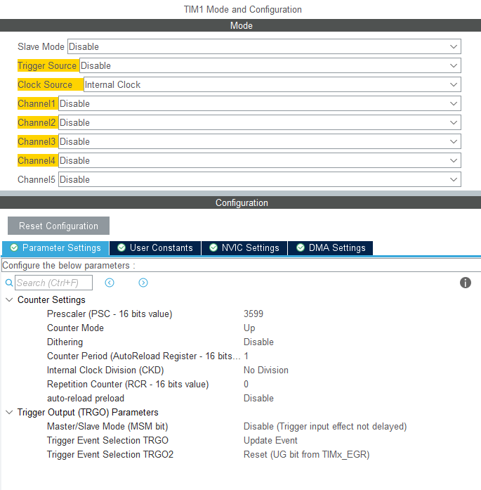

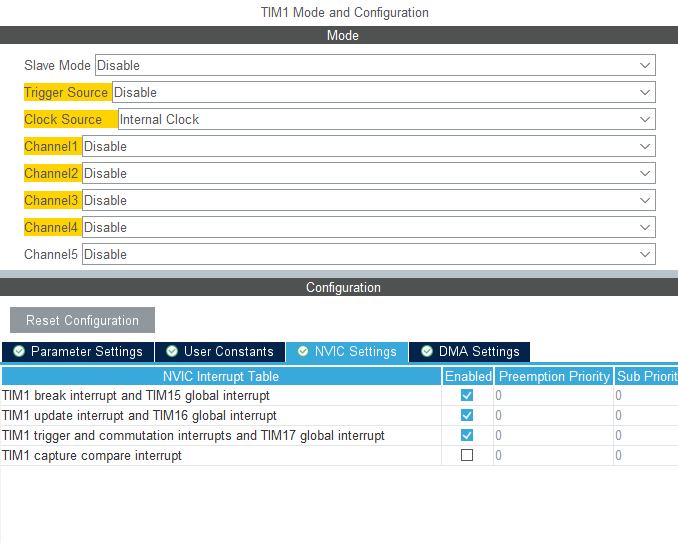

‎2023-05-22 4:38 AM - edited ‎2023-11-20 5:03 AM
I've looked your CubeMx setup.
It seems TIM1 is only used to trigger ADC3 using TRGO internal event. In this case, do you really need TIM1 interrupt?
ADC3 in 8bit resolution in scan Mode for IN1 with IN12 in single-ended channels and using DMA request is also ok.
Concerning DMA Settings, I don't understand why Channel = ADC3 ?
It should normally corresponds to the physical DMA (like DMA1 Channel 1) (see my image below)
Can you check it?
The DMA is set in Circular mode. As your code start ADC3 conversion once, maybe it will be better to set DMA in normal mode.

Thanks for the detailed answer!
- TIM1 only triggers an event, does it mean no interrupt needed and TIM can be started with HAL_TIM_Base_Start() ?

- HAL_ADC_Start_DMA -> flag on complete -> HAL_ADC_Stop_DMA. I did this configuration before and then made some changes to CubeMX and didn't manage to return this method back to work. What CubeMX setup is needed for this? Is this "Continuous conversion mode"? What is "Discontinuous mode"? What should be in "DMA continuous requests"?
>Yes TIM1 TRGO Update is an internal event and happens during overflow of counter. It does not needs to generate an interrupt. Yes only HAL_TIM_Base_Start() is needed.
- Not sure why it showed "ADC 3" as a dma channel. I checked DMA channel cell - it shows correctly.
>It doesn't matter, sometimes some thing can't be explained !
>CubeMx keeps the user code written into following tags:
/* USER CODE BEGIN 2 */
/* USER CODE END 2 */
And many other...Your code is thus preserved if you regenerate it with CubeMx.
Continuous/Discontinuous mode are specific to ADC, not to the DMA.
DMA perform only request to peripheral (here ADC) and transfer each data to the memory (here the SRAM)

‎2023-05-23 12:23 AM
Hi VL.3 (Community Member)
The scan mode is already configured in your application (ADC3_IN1 and IN12) but the conversion is discontinuous because you need to trigger ADC3 with TIM1 TRGO.
When ADC is configured in continuous mode, it is started once (by software or timer) and it does conversion infinitely until it is stopped. Continuous is also suitable.
You'll find in an attachment a STM32CubeIDE project on Nucleo-G474 that perform the ADC3 IN1 and IN12 conversion triggered with TIM1 (trigger period is 100ms)
As explained yesterday, the ADC3 and the DMA store IN1 and IN12 rank in a array of 32 elements (adcBuffer[0] = IN1, adcBuffer[2] = IN12.....adcBuffer[30] = IN1, adcBuffer[31] = IN12)
and split the 32 samples into 2 independant arrays of 16 samples each (IN1 and IN12).
Can you try it, and tell me if it help you?
