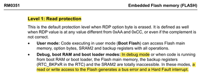

> I need to do:
> * Full flash erase
> * Write Application image (.hex or .bin)
> * Write Bootloader image (.hex or bin)
> * Set RDP level 1
> * Start the application at the Bootloader start address.
It's not possible to do the last step. You can't run flash in RDP 1 in debug mode. The chip needs to boot up normally.
NArnd
NArndAuthor
November 27, 2025
Thank you TDK,
So, I need to do:
> * Full flash erase
This works in the STM32CubeProgrammer 2.21.0 GUI. (And setting RDP to level 1 as an individual step.)

Unfortunately, the RESET switch approach doesn't work when an RDP level change is done.
The Option bytes must be re-read and re-loaded, which happens at a Power On Reset (POR) or when bit FLASH->CR OBL_LAUNCH is set. The latter is not accessible via SWD/JTAG after RDP has been changed to 0xBB or 0xCC.
There is hope that a usable sequence can be achieved by changing RDP to 0xBB and setting bit FLASH->CR OBL_LAUNCH from program code.
