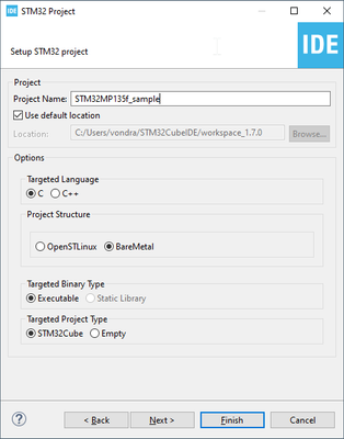

Hello
Can I use Windows and STM32CubeIDE to develop application using STM32MP135FAF7 (STM32MP135F-DK discovery kit).
I tried to create empty project based on this discovery kit but it ended with message
"This project requires OpenSTLinux version 'openstlinux-6.1.-yocto-mickledore-mp1-v23.06.21', setup it now ?"
and finally error message "This operation is only supported on Linux!"
I would like to program "bare" A7 chip using STM32IDE using STLink, is it really possible ?

Dear @Erwan SZYMANSKI,
thanks for response. I fellow up already steps from AN5360 (an5360-getting-started-with-projects-based-on-the-stm32mp1-series-in-stm32cubeide-stmicroelectronics.pdf)
STM32 New Project
Board Selector - STM32MP135F-DK
I forgot to swap to bareMetal. I must have been blind
In meanwhile I also tried another approach to generate IOC with CubeMX and import to CubeIDE it will create working project... I was still wondering where I made a mistake in CubeIDE.
So many thanks for these another wiki pages.

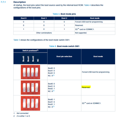

@ravo ,
Some attention point that could help your case :
1) Did you double check that connectivity was good (cf the article) and the boot pins are set to "engineering mode" ?
2) Did you double check your Debug Configuration regarding following article ? https://wiki.st.com/stm32mpu/wiki/STM32CubeMP13_Package_-_Getting_started#Download_and_run_an_example_from_SYSRAM
Kind regards,
Erwan.
Dear @Erwan SZYMANSKI ,
Thanks for your support.
Regarding point 1:
What do you mean with "Did you double check that connectivity was good (cf the article)" ?
Engineering mode verified.
Thanks for correction the engineering mode. I read um2993-discovery-kit-with-1-ghz-stm32mp135fa-mpu-stmicroelectronics.pdf (https://www.st.com/resource/en/user_manual/um2993-discovery-kit-with-1-ghz-stm32mp135fa-mpu-stmicroelectronics.pdf) and in chapter 7.7.1 there is "reserved" instead "engineering mode". So prior to your info I set-up 000 to USB boot for programming... So this could be corrected.
