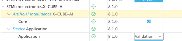

When I wrote the question I was on IDE version 1.13 under Mac OS Ventura. Since it worked for you I assumed it must have had something to do with my version or something with my computer setup, so I tried on a windows 10 PC and installed a fresh copy of 1.14.0. I ran in to the same problem. Here are my repro steps:

- Click X-CUBE-AI and click core and in the application dropdown select validation. Like the image in my earlier post. Then select OK to close that view.
