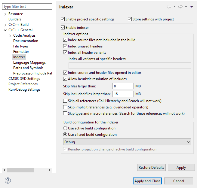

ā2020-03-27 2:13 AM
thank you for quick response.
I use Version: 1.2.1
Build: 5190_20200115_1224 (UTC)
When i CTRL + left mouse click a function name, this should switch me to function definition (or define, variable, etc...). This works for functions automatically generated from CubeMX. (For example function HAL_GPIO_WritePin works as expected.) But it doesn't work for functions written by myself. IDE throws a error Could not find symbol "function_name" in index. In Attolic, this was working well.

ā2020-04-29 2:13 AM
Hello.
I finally solved this problem.
Here's how for everyone with the same issue:
1) Go to Project->Properties.
2) Search for indexer.
3) Set to this setting:
4) Rebuild index.
I don“t know, what setting is responsible for fixing this issue, but everything is working now, and this is what is important for me.
Thank you all for help.
