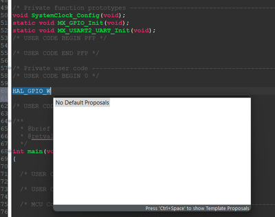

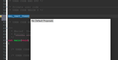

I m quite negatively surprised that suddenly (Ctrl+Space) stoped proposing any functions, as it is shown below:
or
I didn't change any settings, and suddenly it stopped working.

Best answer by TDK
You can't call a function at the global scope. If you autocomplete within the main() function (or any other function), it will provide valid functions.
2 replies
TDKBest answer
May 8, 2025
May 8, 2025
Thx, thats true as I ve checked , but why is it impossible to call a function at the global scope? I ve came across a tutorial where all the code was written in the global scope, so before the main function and everything seemed to work.
May 8, 2025
That's how C works. The entry point is in main(). You call functions there.
Technically you can call functions in assignments at the global scope, but that is not what is being done here.

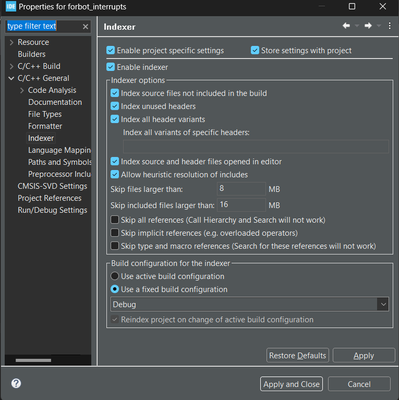

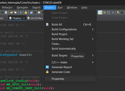

June 22, 2026
^ Enabling Indexer worked for me
