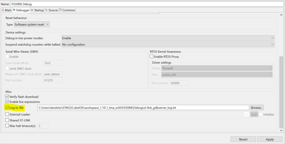

Could you also supply the log-file? It will be created if option “Log to file�? is enabled in the debug settings.

I put the log file in attachment. It seems the problem comes from a command "vKill" which is not supported?
"[6.746] read(): <752> Rx: $vKill;a410#33
[6.746] handlePacket(): Hidden/Unsupported v-command 'vKill', see RSP for details"
