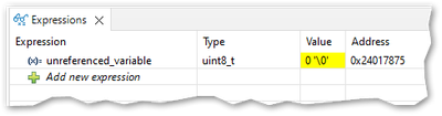

OK, I stumbled on a workaround while browsing the linker script. I added line 9:
.bss :
/* This is used by the startup in order to initialize the .bss section */
_sbss = .; /* define a global symbol at bss start */
__bss_start__ = _sbss;
*(.bss)
*(.bss*)
*(COMMON)
KEEP (*(.bss.unreferenced_variable*))
. = ALIGN(4);
_ebss = .; /* define a global symbol at bss end */
__bss_end__ = _ebss;
} >RAM_D1
And there it is:
Bafflingly, this works even if 'used' attribute is not applied. I would have thought it would be the minimum necessary to emit the variable in the .o file and that the KEEP line would be the last piece of the puzzle, but no.
So 'used' is still, frankly, pointless.

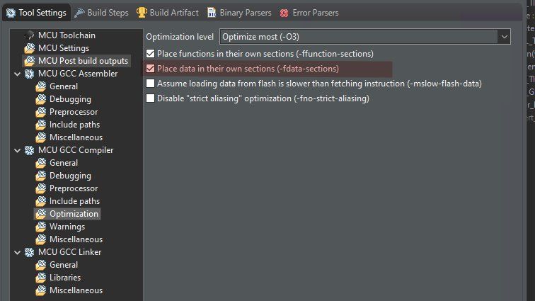

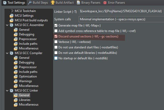

‎2024-07-03 4:32 AM - edited ‎2024-07-03 12:54 PM
The binutils version for my old(er) CubeIDE is 2.38.20220708, so that's not the issue.
It must be the ABI requirement that's not met.
> I'm sure they will come back to explain why it doesn't work.
The 'used` attribute is working exactly as intended. If you remove the "--gc-sections" linker options, the variable will appear in the output.
The default linker options for Cube projects (helpfully) include "--gc-sections". Which means you've asked (*) the linker to prune the variable (to the linker, this is just an unused section). This also, is exactly as intended.
I suggested `retain` as a workaround since you could have used to achieve your goal. Unfortunate that it isn't supported as you rightfully pointed out.
You could certainly ask ST OLS for advice on how to achieve your goal. I can suggest one as well:
- remove "-fdata-sections" from the compilation flags. Be aware that this may result in a larger final binary (**).
Overall, we've definitely answered your original question (as stated).
