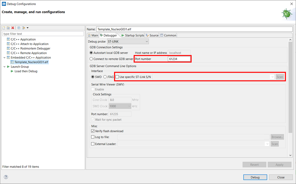

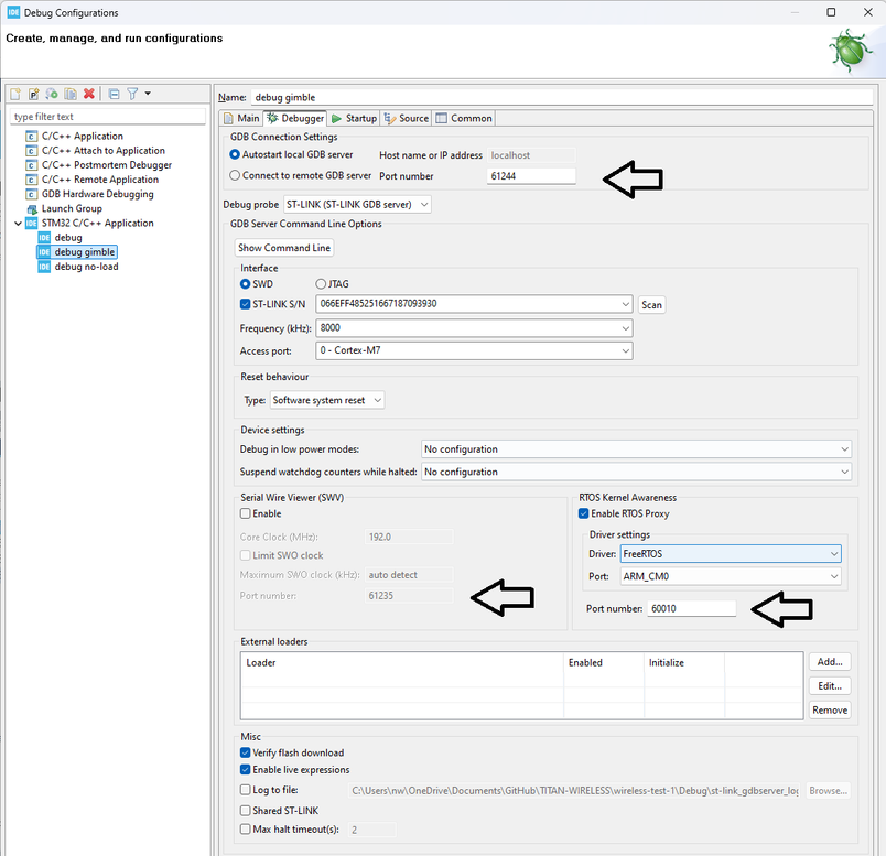

I believe the issue is that both GDB servers are using the same port (usually it is port 61234). You should try to change the "Debug configuration" -> "Debugger" -> "GDB port" for one of the 2 IDE instances (I'm not using CubeIDE, so I can't help precisely here), and maybe also specify the ST-Link serial number to use for each debug instance, so the IDE knows which debugger to use.
See the picture below for Atollic:

July 31, 2024
Don't forget to change the ports on your RTOS Kernel Awareness and Serial Wire Viewer if you're using them.

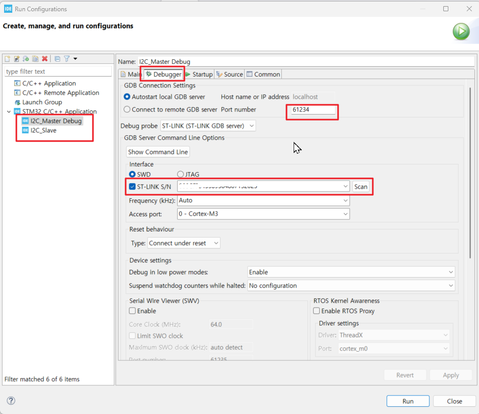

Graduate II
April 22, 2025
Just for your information.
The chapter number 3.6.3 Debug multiple boards mentioned by ChahinezC is now chapter 3.1.6.3 Debug multiple boards of user manual UM2609 as of today, April-22-2025.

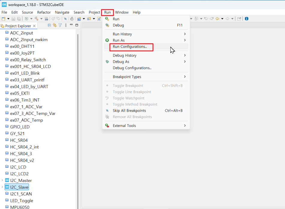

Menu of STM32CubeIDE is also slightly changed on STM32CubeIDE 1.18.0.
Select Run >  Run Configurations... , and you can find Run Configuraions window.
