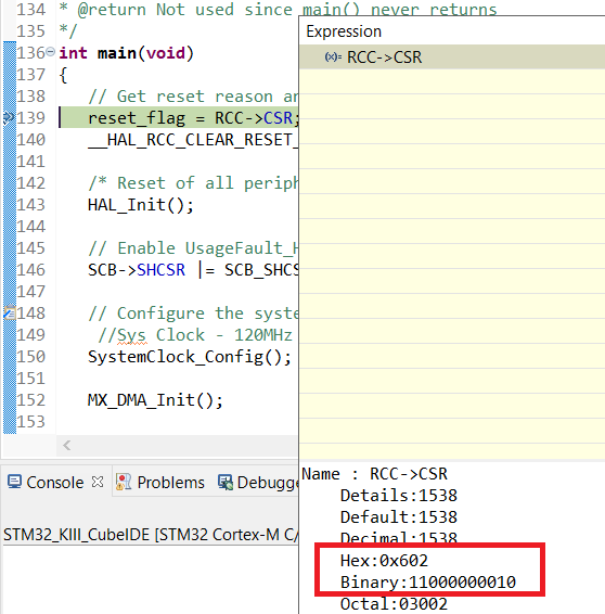

Details:
MCU: STM32L4R9ZGJ6
IDE: STM32CubeIDE v1.6.1
SDK: STM32Cube_FW_L4_V1.14.0
Board: Custom PCB

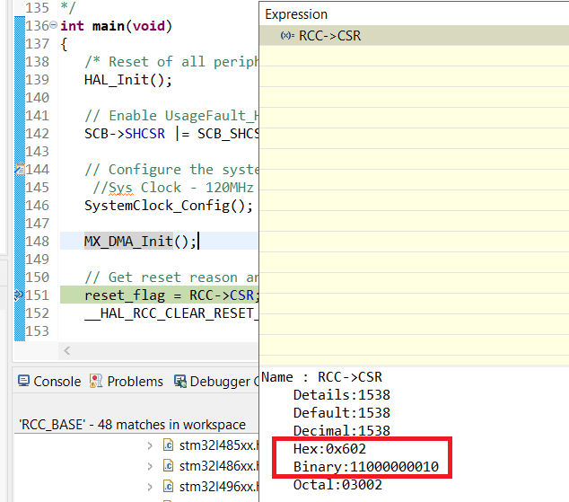

I am seeing really strange behavior where bits 31-24 in the RCC->CSR register are usually always 0. I have verified this behavior on two boards. The only bit I ever see set is PINRSTF but only after programming the board with the debugger attached. Subsequent resets with NVIC_SystemReset(), toggling NRST, watchdog reset, etc do not set the reset bits accordingly.
I have tried reading the registers after basic system init and immediately upon entering main() with the same result. Below are two tests that read RCC->CSR just after calling NVIC_SystemReset().
Test 1 (Read CSR after basic system init):
Test 2 (Read CSR as soon as main() is entered):
I can't figure out why this would be happening. I skimmed through the MCU erratas and didn't see anything, but I could have overlooked something.

I think it just dawned on me. This device uses a bootloader so I imagine the HAL API in said bootloader might be clearing the reset bits. This would explain why they are only set when I program the device because the PC (Program Counter) jumps to the start of the application and the bootloader is not run. That has to be it. I'll update this post once I confirm.
Edit:
My suspicion was correct. The bootloader calls HAL_RCC_DeInit() before jumping to the application.
