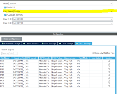

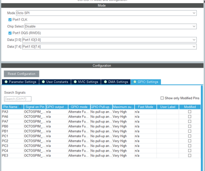

I want to use L4R9's OSPI interface.
I only have a microcontroller board, and I want to test whether it can send data.
During the test, I found that the HAL_OSPI_Transmit() function never sends data,
and the oscilloscope cannot pick up the waveform.
It is speculated that the reason is that the NCS film selection cannot be lowered.
My board is in the OSPI_READY state after powering on, and even though I added the write enable function,
there is no way to realize data transmission. Even if the chip select line is forcibly set to GPIO type and manually pulled low in the program,
the HAL_OSPI_Transmit() function still cannot work. My cube configuration and test program are as follows:maya123_0-1730275514056.png

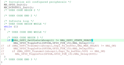

Sorry  my mistake.
I forgot to post the code.
Since other interfaces on the board (USART, I2C, etc.) are occupied,
at this stage I can only judge the status of the team through the flashing of the LED light.
Here is a screenshot of my code:
There is an initialization part in the code,
and the light does not flash after powering on.
I think it means it is in the OSPI_STATE_READY state.
Regarding the instruction structure, I will try again.
Thanks!

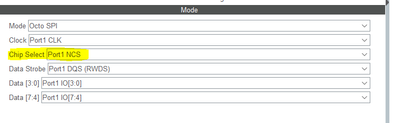

Imen.D
Hi @maya123 ,
The Chip select pin is not configured, that's why "NCS film selection cannot be lowered."
So, try to enable chip select pin.
Thanks
Imen
