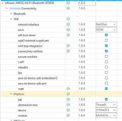

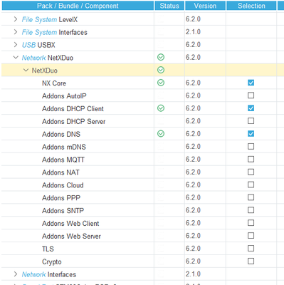

I'm using STM32L4R9 (I have L4R9I-Eval and on my custom board I am using STM32L4S9ZIJ6) with CYW4373 (I am using EAR00436 and its uSD Adapter, which use 2BC module from Murata which is also mounted directly on my custom board), with ThreadX and NetX Duo. I am configuring the driver on STM32Cube IDE and using the Manage Software Packs in IOC file viewer and selecting Infineon Wi-Fi Drivers with the below specs:
I connected the module on the uSD slot on the devboard using uSD adaptor and followed the guide here(point 8 in this guide). I'm unable to boot up the WiFi module this way, I am encountering the following error:

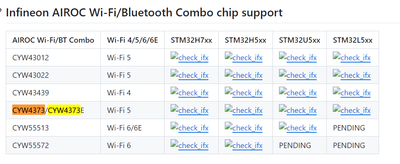

Hello @_uttam ,
After checking the Infineon/AIROC github repo you can see that the STM32L4 series of MCUs including STM32L4R9 are not supported for your module.
