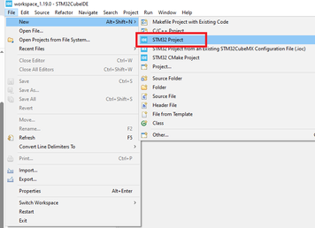

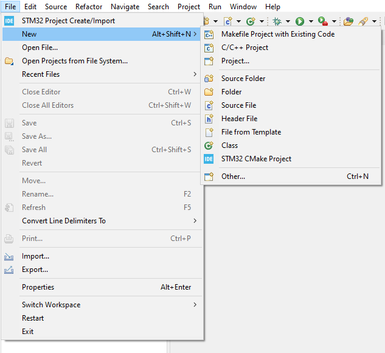

No it cannot. probably you are talking abaout a previous version of CubeIDE. CubeIDE 2.0.0 and later versions cannot create project for STM32.
As you can see that option in CubeIDE 1.19.0:
Is no more available starting from CubeIDE 2.0.0:
