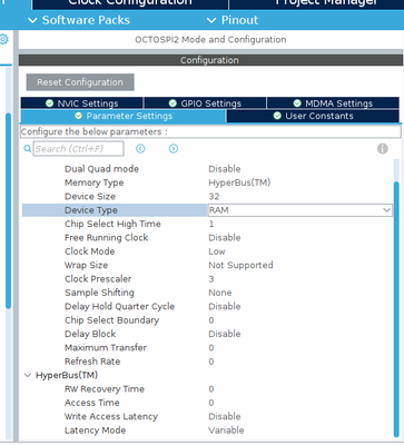

I'm trying to configure the external memory on an STM32H375 board using CubeIDE, but I'm not achieving success.

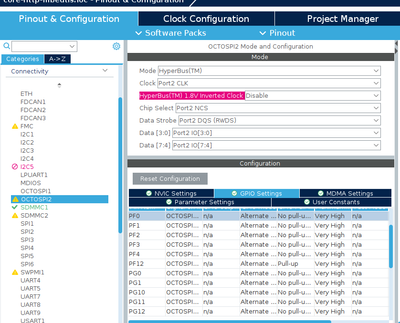

Let me explain how I'm doing it: I enable OCTOSPI2, set it to HyperBus mode, choose port 2, and configure the corresponding pins.
Regarding these options, I'm not quite sure which ones to choose:

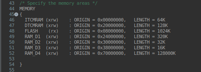

This is my linker file:
If I put ">RAM_D1 AT> RAM_D4," the data is not assigned. If I put "RAM_D4," the data is assigned, but when I load it onto the board, it doesn't work.

Would you share your schematics? datasheet of your memory? In linker script, are you sure about memory size? 128000 KB?
About options, you need to refer the specifications in the reference manual to learn about them. These modes are fundamental to make it work.
