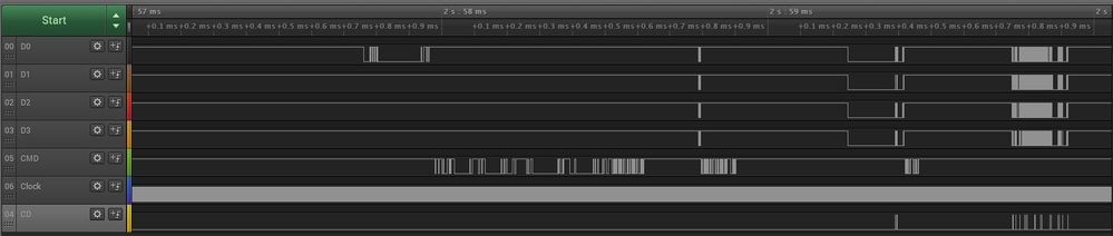

Has anyone else had problems with the SDMMC peripheral on the H7 since the CubeIDE 1.8.0 Update. I have some old projects I went back to that had previously used this peripheral and now when mounting the SD Card I get a FR_NO_FILESYSTEM error. I have also started from scratch with a new project and ran into the same error.

Looking at the logic analyzer from test on the old project this is the expected communication protocol
0693W00000HoU7tQAF.jpgCurrently I am now seeing this communication

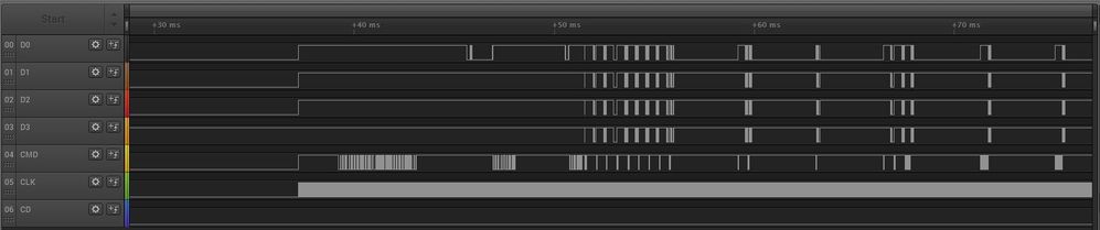

0693W00000HoU83QAF.jpgIt seemed odd to me to see so much movement on the card detect line.
There are currently internal pullups (through the CubeMX) on each of the data lines and the Card Detect line.
Jaboop
Ended up being a signal integrity issue. Changing Pull-Ups from internal in CubeMX to external Pull-Ups on my circuit fixed the issue.
