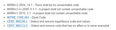

But when my code is analyzed by SonarQube, I have a bug report: 'return' will never be executed.

For more information, here is the SonarQube rules :
Indeed in your case the return will never reached because of the while(1) loop. But, normally, it should be treated as a warning not an error.

I'm talking about quality. Not about compilation error.
The program compiles well and runs. But SonarQube (quality tool) return that the first code is not well written.

Since C99, int main() does NOT have to return anything. Now you can understand why they made this improvement ))
Here, its not about code quality, but about follow the norms of your compiler.
