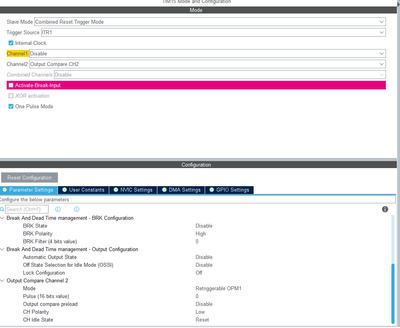

STM32CubeIDE TIM15 OPM settings are missing
PKurz.1
STM32CubeIDE Version: 1.14.1 (and earlier)
after selecting One Pulse Mode, the settings for this operating mode do not appear.

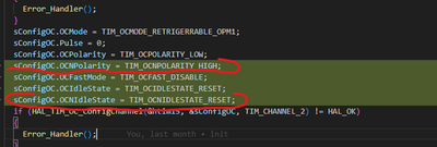

First launch and...
One bug fixed and a new one generated. Who's verifying this? Now it'll take another two years to fix?
I don't have an additional timer OC2N.
