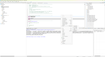

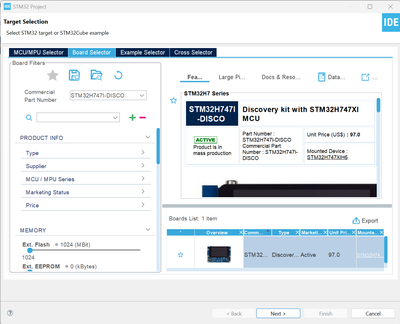

The board I'm using is STM32H747I-DISCO, and the tool I installed is STM32CubeIDE 1.19.0.

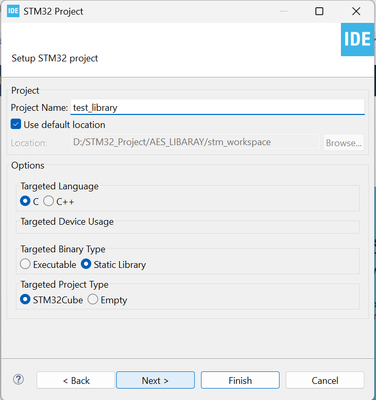

I want to build a static library based on it.

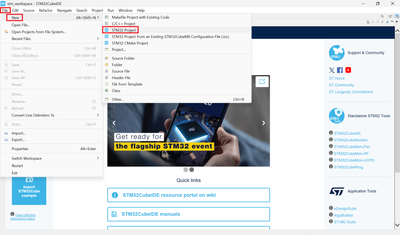

Therefore, I run the following steps to create the library.

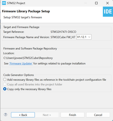

File -> New -> STM32 Project

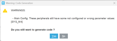

At this time, I got the following WARNING meesage.
Does anyone know how to solve this issue?

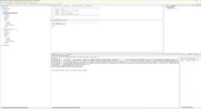

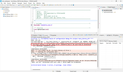

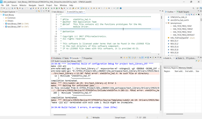

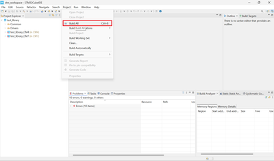

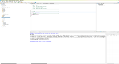

I tried to build the generated project using the following actions.
And then, I got the following errors.

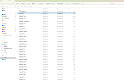

However, this file already exists, as shown in the image below.
Did I make any mistakes in the steps I took to create the library? And how can I resolve these issues?

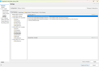

Ghofrane GSOURI
Hello @jovewu
To resolve this issue , please follow those steps :
- Open the two files : stm32h7xx_hal_conf.h. and stm32h7xx_hal.h
- Right click on the  stm32h7xx_hal.h  then select show in option then System  Explorer
This will open the path where the file is placed , copy the path
- Right click on the CM4  project --> Properties -->C/C++ Build -->Settings -->MCU/MPU GCC compiler -->include paths : add the copied path --> Apply and close
- Do the same thing for the stm32h7xx_hal_conf.h
- Redo the work for your CM7 project
Then build your two projects : will get 0 Errors 0 warnings
