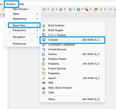

Is there an option in the STM32CubeIDE settings to reset to factory settings or something like “Default Settings”?
I can’t restore the console window to its original state. When I compile the code, the console window used to appear at the bottom, but now it doesn’t show up anymore.

mƎALLEm
Try to activate it as the following:

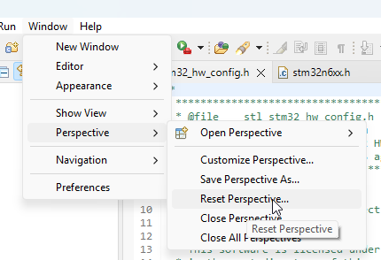

I know how to reactivate the console. But it opens as a separate window. However, when I first installed STM32CubeIDE, it did not open as a separate window.
Window > Perspective > Reset Perspective
