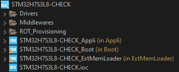

"Project Explorer":
The project names "Boot" and "ExtMemLoader" have little warning signs on the icons. What do those mean?

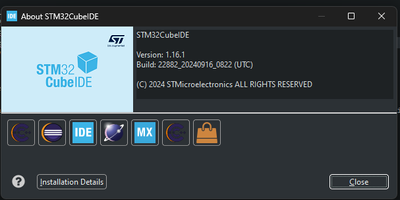

The STM32CubeIDE version I'm using is the latest:
I looked a little deeper into the issue and found that after the "ExtMemLoader" project is built, the " postbuild.sh" script is running. This script renames the .elf file and copies it to two different locations.

I still don't know what those warning signs on the project icons for the Boot and ExtMemLoader projects mean.
