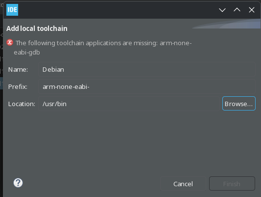

I just saw that STM32CubeIDE upgraded STLink firmware... but I can't see why you should distribute your version of gcc, gdb, openocd (the debian udev seems to be outdated and overlapping, I bet Debian and openocd devs will love you for helping them making their software better and you'd make it more portable).
[*] ./plugins/com.st.stm32cube.ide.mcu.externaltools.gnu-tools-for-stm32.13.3.rel1.linux64_1.0.0.202410170706/tools/bin/arm-none-eabi-gdb --version
error while loading shared libraries: libncurses.so.5: cannot open shared object file: No such file or directory
I do know why this doesn't work... newer gdb in debian comes with support for multiarch... so there is no gcc-arm-none-eab-gdb so there is no dependency on libncurses5... and probably I'm running a working newer version of arm gcc and gdb if I only could simply check.

But the fact that your included toolchain requires ncurses5 is a real pain now.
Unfortunately STM32CubeIDE try to be too smart and when I try to add a local toolchain it complain there is no arm-none-eabi-gdb since debian moved to a multiarch gdb. This could probably be resolved by a symlink but it's not very nice to tweak with system stuff as root and I don't know if it is going to be maintainable.
You'd make adding a local toolchain more smart or less smart.

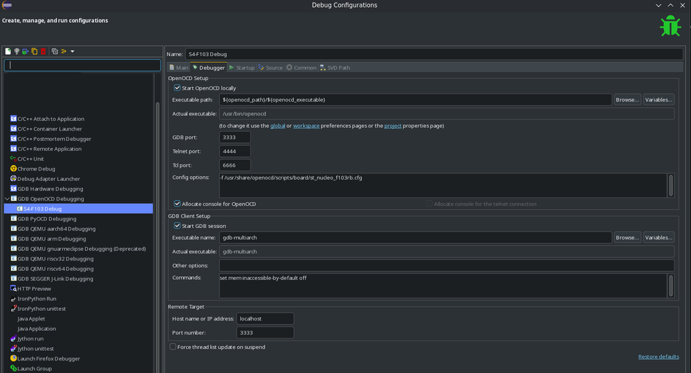

Embedded CDT uses OpenOCD and the debugger configuration is set in the GDB OpenOCD Debug option menu.
The equivalent setting would be in STM32 C/C++ Application -> project Debug. But there is no option where to chose the gdb binary.
