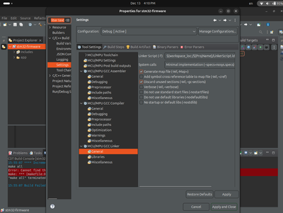

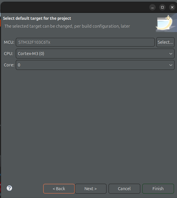

Target MCU: STM32F103C
I'm new to using STM32CUBEIDE
I have noticed when i created the C/C++ project and chose the target MCU something off maybe that is the issue
find the photo down below.
I have added an app directory only 
app/
|- main.c
|- inc
     |- main.h
both files are empty i did not write anything yet  just a main function that returns 0 and when i build it says
"Error: Cannot find the specified linker script. Check the linker settings in the build configuration.
make: *** [makefile:85: fail-specified-linker-script-missing] Error 2"
is there something I should configure? or am i missing something?

Ghofrane GSOURI
Hello @ziadAhmed19
In the latest release , STM32CubeMX is no more integrated in STM32CubeIDE 2.0.0
For more details , please check this STM32CubeIDE 2.0.0 released
To download CubeMX standalone please use this LINK , this tutorial should be a good point to start with the STM32CubeIDE 2.0.0. and STM32CubeMX
THX
GHofrane
