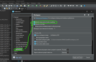

Hint: CubeIDE can auto-refresh the Project Explorer by enabling this native Eclipse feature:
Window   >   Preferences   >   General   >   Workspace   >   Refresh using native hooks or polling
Use with care: If your workspace contains many projects/files, you may notice a performance hit.
