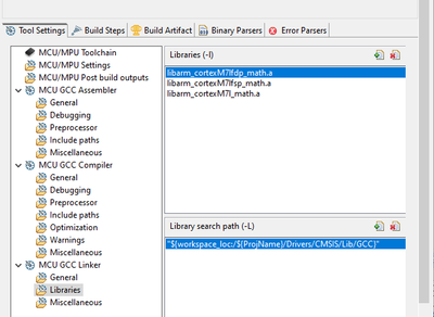

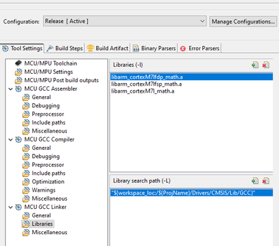

Thank you for your reply,
I set the configuration as "Release", then I insert the library name and the library path into the MCU GCC Linker -> Library
CarloV
CarloV

So, again, carefully compare & contrast the settings for the two configurations ("Debug" and "Release").
Ok,
they seem the same...what concerns the linker (GCC linker), there are no differences...do you think that I have to check other part of the setting ?
