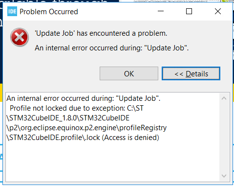

Hi Markus,
it seems you were right and spotted the cause of the error.
On that machine I was indeed lacking access rights to the .\configuration folder. Fixing only that did still not solve the problem completely: I was then able to start the IDE. Shortly after startup, I got the following error message: 'An internal error occured during: "Update Job". Profile not locked due to exception (...) .lock (Access is denied)".
0693W00000LwGuoQAF.pngI was finally granted access rights to the whole parent folder STM32CubeIDE. I still don't understand why I don't have these issues on my local machines as both must have been installed by administrators (IT department or colleages with more privileges).
Hopefully posting the details here may help somebody else.
