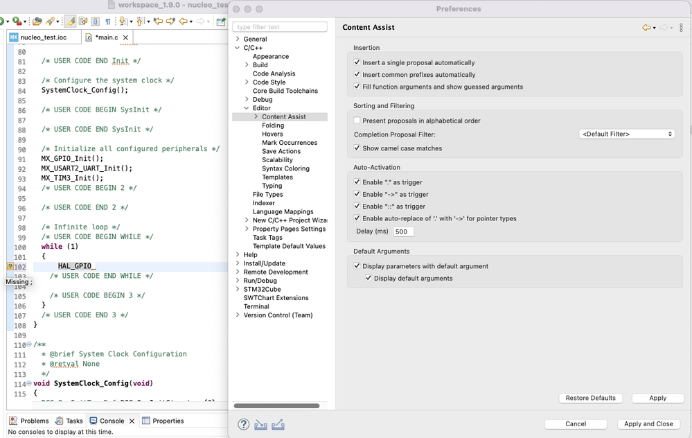

I am using macOS and I found that the content assist is not working when I press either "ctrl + space" or "command + space".
Is there any setting I missed?

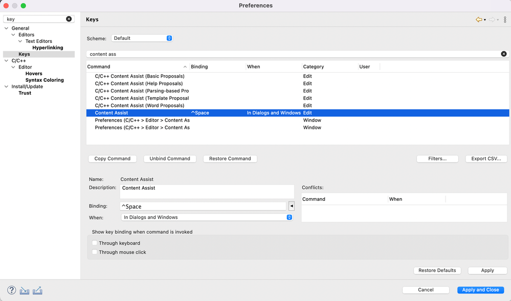

I found that the answer. It is a mistake... For macOS, content assist is option + / . Thanks a lot!

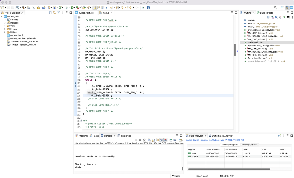

Does the project build? If you press F3 while on a function, does it jump to the definition?
You can try rebuilding the index with Project -> C/C++ Index -> Rebuild...
‎2022-03-27 8:13 PM
I pressed F3, nothing happened...
After I rebuilt it, nothing happened as well...
and I tested the LED function. It worked. I think the project has been built, but I do not know why I can not use content assist...

If you prefer another keybind you should be able to change it with the following setting
