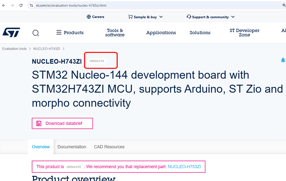

Hello team, I am new to STM32CubeIDE. I have a NUCLEO-H743ZI2 board. When I try to open an example project, it shows the message: 'Target NUCLEO-H743ZI2 is obsolete according to marketing status,' and the .ioc file is not generating. I have already installed the latest version of the IDE. Could you please help me resolve this issue?

Andrew Neil
Welcome to the forum
Please see How to write your question to maximize your chances to find a solution for best results
What CubeIDE version are you using?
It is correct:
mƎALLEm
Hello @ramdev29 and welcome to the community
It shows a pop up message indicating it's an obsolete board but the code is well generated.
What is the CubeIDE version you are using?
CubeIDE 1.19.0?
@ramdev29 see this post regarding recent issues with older versions of CubeIDE not creating the .ioc file.
Hi Team,
code is generated but when i try to open device configuration tool it is showing blank .
IDE Version: 1.18.1
@ramdev29 wrote:
IDE Version: 1.18.1
That is one the versions which seems to be affected by the issue mentioned above.
Try updating to the latest - 1.19.0.
@ramdev29 wrote:
IDE Version: 1.18.1
The latest version of CubeIDE is 1.19.0
Please uninstall the previous one and insatll the new one.
thank you ,it is working now
