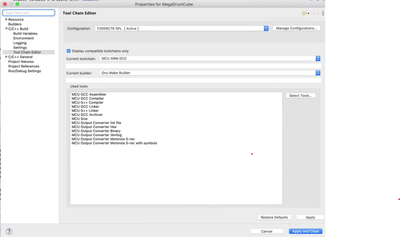

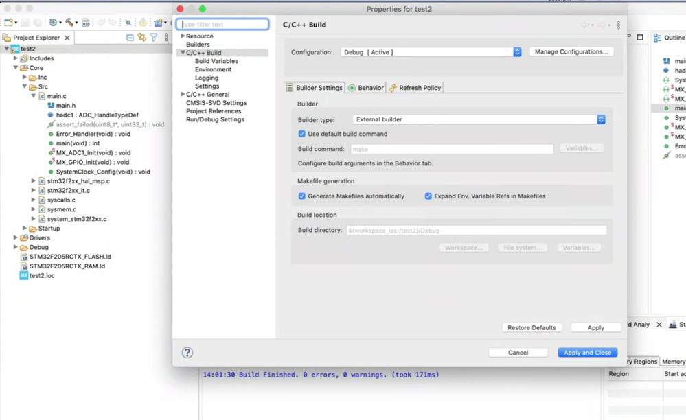

I don't know if it is relevant but in both 1.13.2 on Catalina and in 1.14.0 on Windows in Projects 'Properties->C/C++ Build' I have 'Tool Chain Editor' subsection but it is missing in 1.14.0 on Catalina.
1.14.0 on Catalina:
1.13.2 on Catalina:

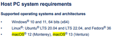

Hello @kayuk  and welcome to the community,
According to the release note of STM32CubeIDE 1.14.0, the required  macOs systems are Monterey and Ventura as shown in the screenshot

I know that, and I stated it the first post. But that macos requirements were there for 1.13.2 yet it was working fine.
