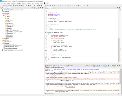

This latest version 1.13.0 seems to give error to sysmem.c like this:
CubeIDE 1.12.0 compiles the same project without any problem.
Projects are generated from TouchGFX template (4.21.4 or 4.22.0) and then imported and compiled in CubeIDE. I know that this can be fixed by changing caddr_t to void or including <sys/types.h> to sysmem.c
But what is the reason for this different behavior in CubeIDE 1.12.0 and 1.13.0 , new GCC version ? I'm afraid this will cause more issues to people how is trying to study TGFX.

Hello @JTP1
Yes indeed the GCC version was upgraded from GCC10 to GCC11 with the STM32CubeIDE 1.13.0.
You are right with the solution you have proposed of changing the caddr_t to void* or include the <sys/types.h> to sysmem.c.
With this been said, I will raise the issue internally to review it and provide a permanent solution.
KR,
Semer.
The same here.
i fixed it by replaceing caddr_t with void*
caddr_t seems to be outdated.
Werner

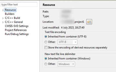

The GCC v11 tools (Cube v1.13) break a few things.
One is the has no explicit encoding set warning mentioned here
https://community.st.com/t5/stm32cubeide-mcu/has-no-explicit-encoding-set-warning/td-p/574835
Despite extensive googling I cannot find a fix for it. The various fixes for eclipse do not work, and neither does the one under project / properties / resource

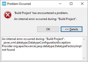

After rebuilding, 1.13 pops up an error, but build is ok.
