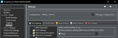

I've been able to solve the issue:
- in the STM32CubeIDE project/properties of your build configuration linker settings, use "do not use system calls from library" and mark box "do not use standard start files"
-the library to reference in your linkerscript becomes libc_a-* instead of lib_a
I also had to create an empty void _init(void) function.
Now my project compiles and links properly, seemingly without major differences with the compiles from 1.1.12 STM32CubeIDE.
I guess, the arm-gcc compiler version was updated...
Hope this helps,
Sylvain

Brian TIDAL
Hi ANauz.1
Those issues are not a bug or a defect from the latest STM32CubeIDE. This is a generic issue of gcc libraries causing a warning at linking stage.
warning: _close is not implemented and will always fail” is not a linker error but a warning placed inside the recent implementation of libnosys as part of gcc libraries. This libnosys provides dummy system calls (read/write/close/lseek) and kindly warns the user during linking stage that any attempt to use those system calls will fail (as this is a dummy implementation). As explained, this is ‘just’ a warning, and the linker is able to generate a proper ELF file. As long as your application does not use read/write/close/lseek (which should be the case for a bare metal application), your application will run properly.
So,
  • the first option is to ignore those warnings.
  • A second option is to patch the libnosys.a to get rid of those warnings (see stackoverflow discussion below).
  • A third option is to provide your ‘own’ implementation of the system calls. You can simply generate a new STM32CubeIDE project with STM32CubeMX and reuse the syscalls.c and sysmem.c files in your initial project.
  • and all other options suggested in this thread (use older toolchain, etc.).
Regarding the multiple definition linker error in your application, this is likely caused by a duplicated object file having the system calls symbols or a duplicated syscall source file: clean your build directory, make sure your source files do not contains several definitions of those system calls. The linker map file should help to find the root cause of the duplicate symbol definition (or use linker verbose mode).
