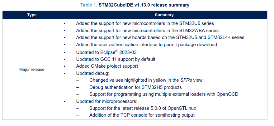

    Same thing happened with me when I updated my CubeIDE. It's becuase of the updated GNU toolchain.
    Go to your project's properties, C/C++ Build, Settings, Open Toolchain Manager, then install a toolchain older than your current one. When done, use the GNU toolchain that you just installed and the issues should go away.
