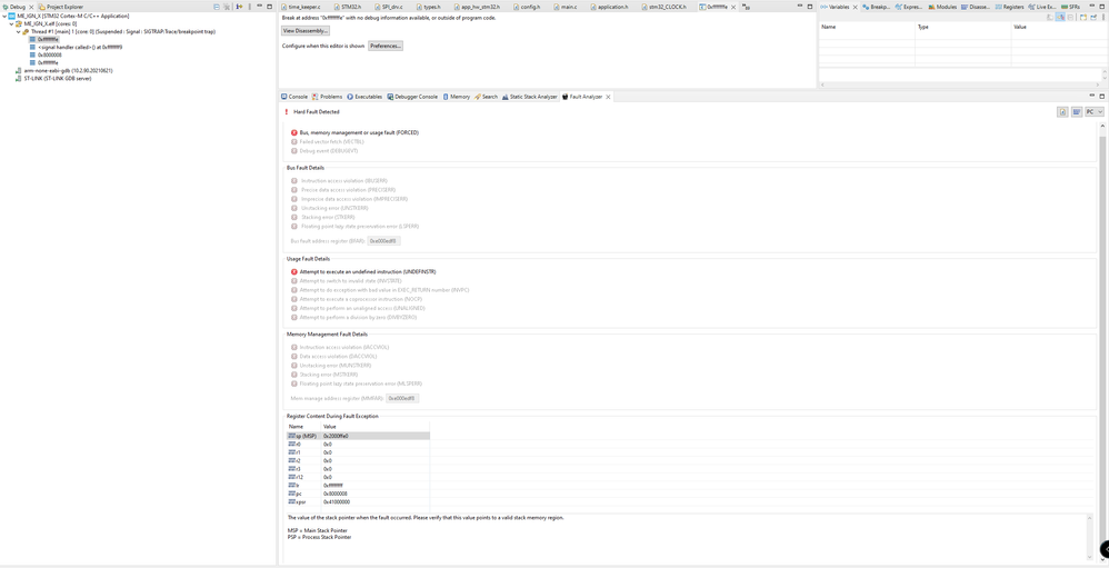

So this is how the call stack looks along with the Fault Analyzer after the initial debugger run. 0693W00000NsuLZQAZ.png
However, if I press the "Reset the chip and restart debug session", it correctly goes to the 'main' routine. The problem there is that it doesn't seem to be able to load the source files and I can't debug. This is odd because:
  1. The simple app can be debugged from the first start of the debugger (I don't need to reset the chip and restart the debug session in order for it to work)
  2. Is able to correctly open its source files

I've attached two screenshots. One shows the Fault Analyzer, the disassembly and the source code, while the other one shows the memory from where it boots. I've also tried putting a handler on NMI, but it still triggers the fault.
