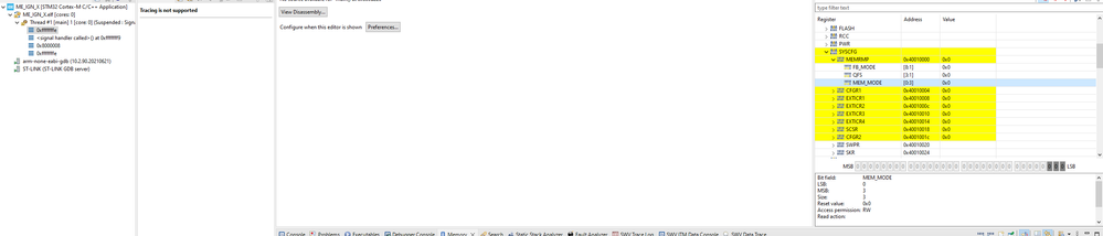

The memory, both when it works (please see message below) is identical between the start address of the flash memory and what it's mapped at 0x00000000 0693W00000Nsu4tQAB.png0693W00000NsuTOQAZ.png
JW,

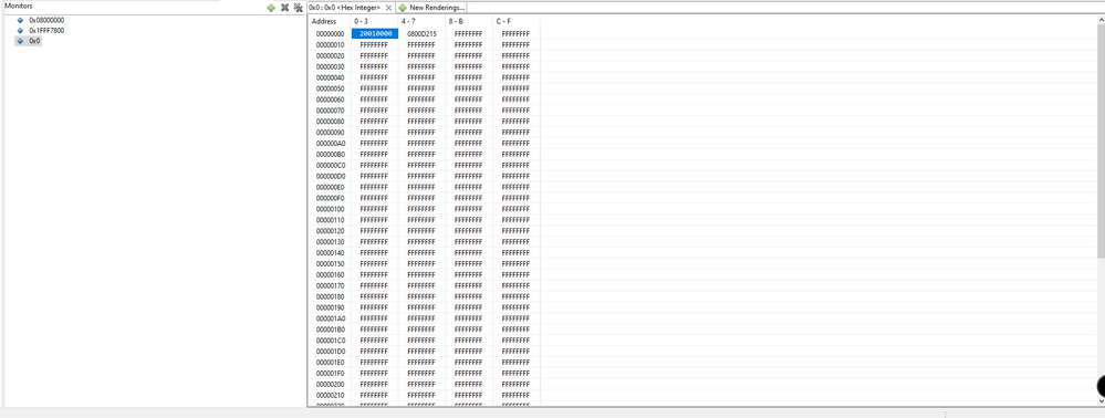

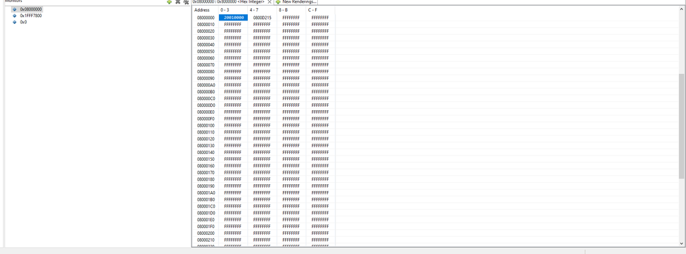

The interrupt vector table is not all 0xFFs. It's a valid solution to only have the first two words of the boot area programmed, one with the address where to put the stack and the other with the address of the reset handler. My problem is that, no matter what breakpoints I put in the reset handler, it never hits it without resetting the debugger once.
Then, as the MCU is initialized, VTOR is pointed towards the beginning of RAM, where the running vector table is stored.

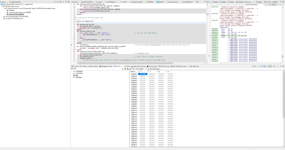

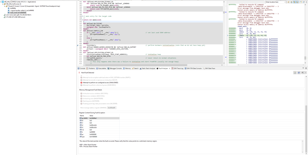

I've attached two screenshots. One shows the Fault Analyzer, the disassembly and the source code, while the other one shows the memory from where it boots. I've also tried putting a handler on NMI, but it still triggers the fault.
Are you sure the SYSCFG clock is enabled in the RCC, reading all zero
I don't think there's any code instruction that gets run in this situation. It just immediately hard faults.
