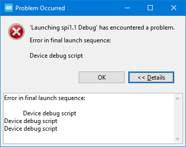

I can't connect via STLink to custom board when enable SWO (STM32H725).
The core clock is 400Mhz.
I use CubeIDE to generate configuration code.
When SWO is disabled, debug run without any problem.

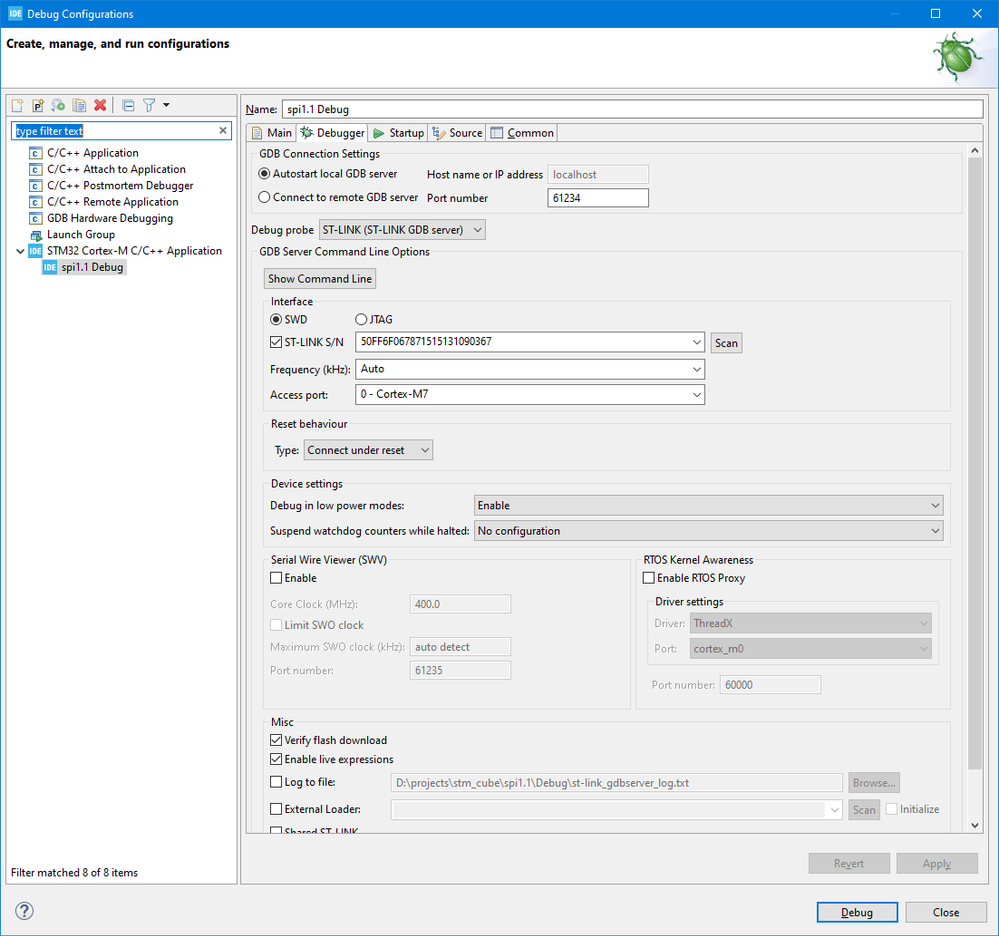

My tool is
ST-LINK/V2 B2018 52, firmwire V2J39S7,
CUBE IDE Version: 1.8.0 Build: 11526_20211125_0815 (UTC),
STM32H725IGK6
I am sure that board is correct, it programmed via SWD, run, debug without any problem. Settings is
0693W00000JOWF2QAP.pngI have not board with STM32H725, but I'll try it later with Nucleo board with M7.

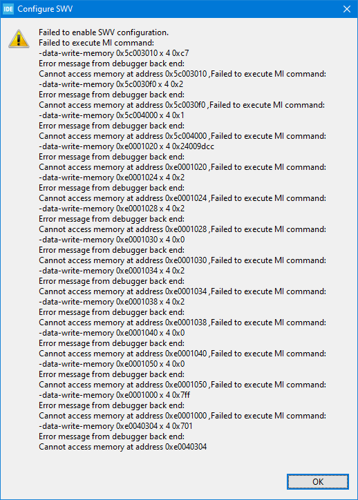

ST Link cannot connect to board until power on reset if enabled SWV. I try configure system clock to 550, 400, 200 MHz.
Yes of course. Could you please make it, or explain me how I can make it himself.
Aleks
Thanks all. It seems the core of problem is missing connection on my PCB - pin PB3 is not routed. Hardware design is not implemented proper. So so, I watch about SWO in the ST youtube channel, try to use it, but video not touch hardware part. And today I am little bit unhappy.
