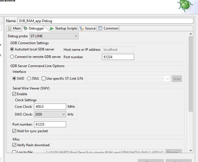

SWO print works fine here on STM32H753I-EVAL2 , wth Atollic 9.3.0 and Keil 5.27 - set up in debugger config as usual, at 400 MHz.
Maybe the problem is in the CubeIDE. Not using it, because of other people's feedback.
-- pa
Than you for the feedback.
Could you confirm that you are using STLink GDB server (in Atollic) and SWV Core clock is set to 400MHz, SWO clock to 2000 kHz ?

Yes. The debugger itself initializes the interface, I don't touch it in the code,
The only annoying thing is that the SVW console in Atollic must be activated manually every time after starting debug session.
Anyone knows how to start it automatically?
