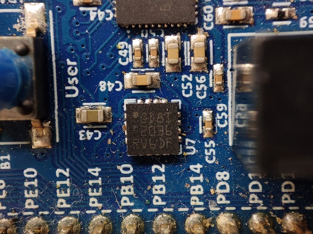

Perhaps the chip is not what you think it is.
#define WHO_I_AM_L3G4200D 0xD3 /* for L3G4200D */
What hardware is this? Post a high resolution in focus picture of the chip.

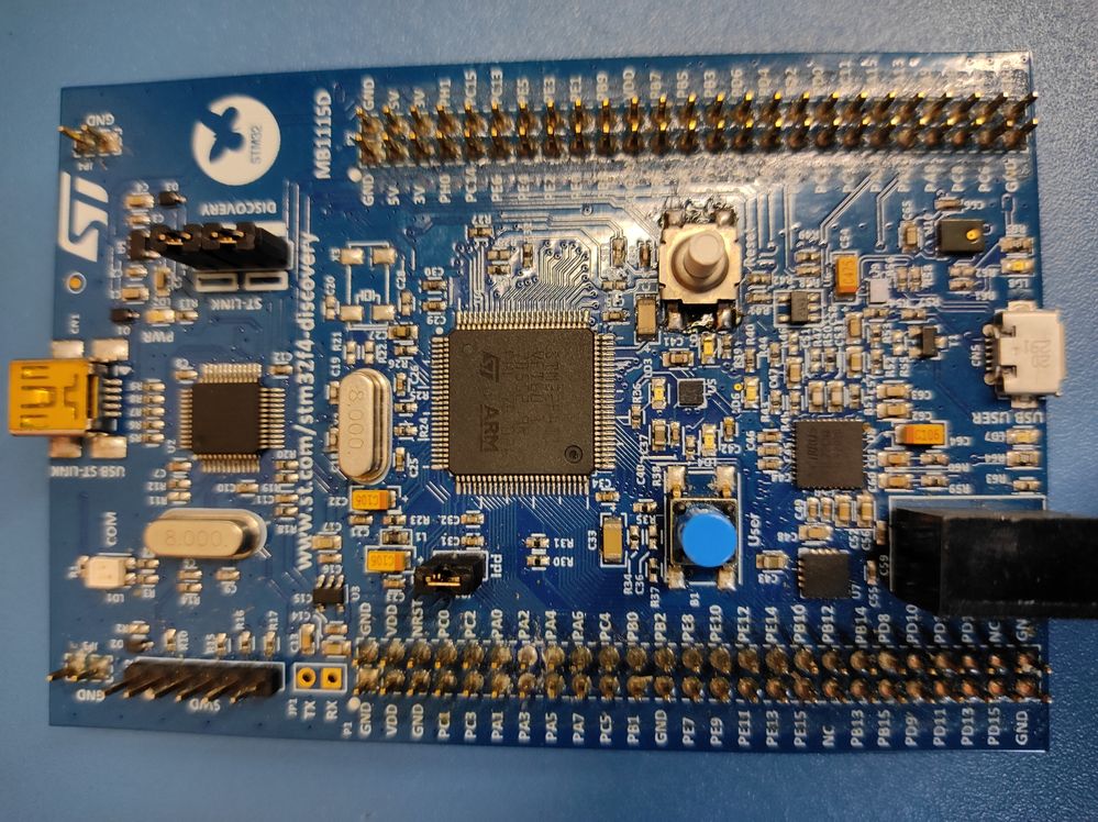

‎2024-02-12 9:08 PM
I am using STM32F411VET6 and also attaching Images of the controller.
Thanks,

‎2024-02-13 6:19 AM
Unfortunately, the markings for that sheet are not specified in the datasheet.
I would guess it's actually a L3G4200D chip based on the register value. Perhaps there are other differences in the registers which you could examine to find out.

‎2024-02-13 7:17 AM - edited ‎2024-02-13 7:18 AM
Hi
if i look at
https://qyriad.github.io/arduino-l3g4200d/html/group__registers.html
is at the bottom of the page
"The chip ID constant value of REG_WHO_AM_I: 0xd3".
so the reading of your code is correct.
<quote of your code>
"Sensor is not connected Received data from register 0x0F: 0xD3"
</quote of your code>
hth
padawan
